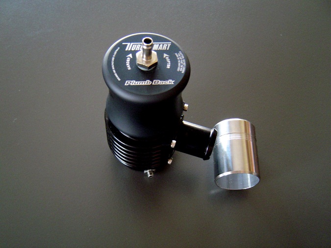

Turbosmart Plumb Back BOV.

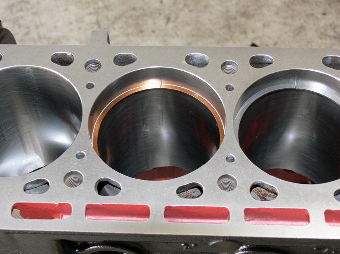

The block back from the machine shop after being bored to 2.5 litre specs.
Старый 22.10.2007, 01:50   #5
The block after being cleaned up.
Fitted the new crank after being balanced along with rods and psitons.

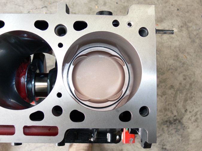

Got the pistons all in.....
The pistons and Verdi Rods....
